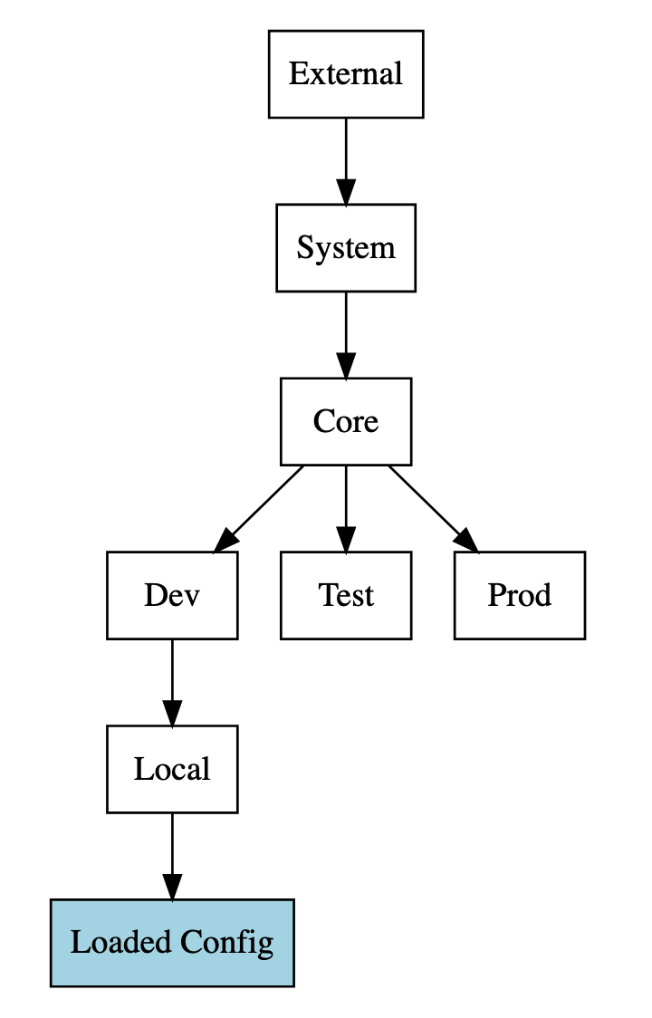

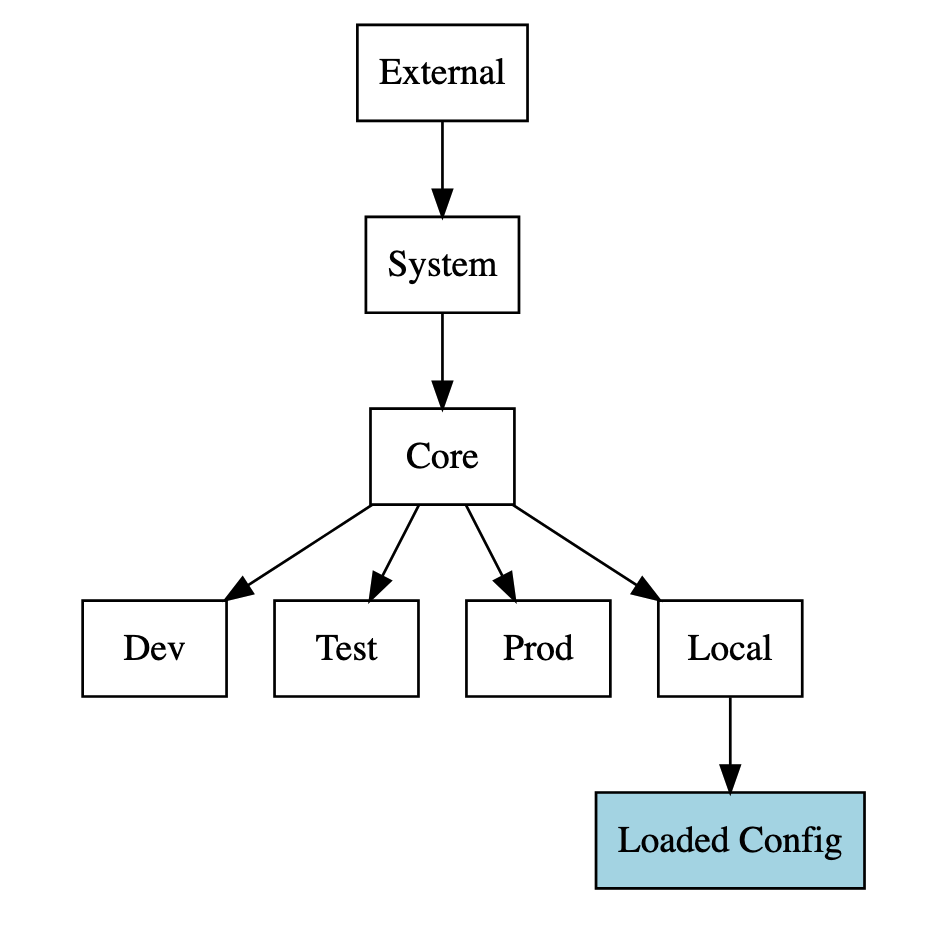

Ignition 8.3 provides a completely overhauled configuration data storage mechanism. 8.3.0's new config system borrows from the project system that was originally rewritten in 8.0 and has stayed basically the same since. Essentially, configuration data is stored in a number of "resource collections" which are automatically loaded in a predefined inheritance order upon system startup. This presents a single, flat configuration view to end users and consumers of the system.
The images below show this configuration and how it will differ when it comes to active deployment modes. The details of how to override this system (e.g. "deployment modes") are usually irrelevant to module authors and SDK users, but the Deployment Modes page in the Ignition User Manual contains more information.
Dev Deployment Mode Test Deployment Mode No Deployment Mode
